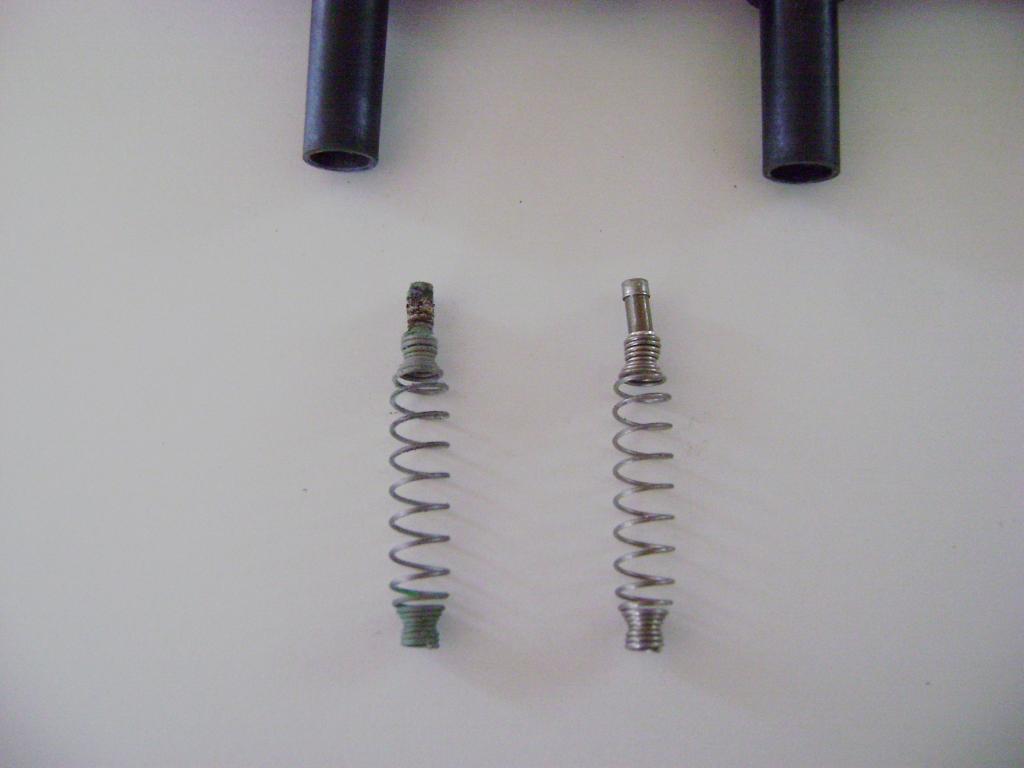

Here is the bad spring next to a good spring and the issue is obvious:
I'm not sure what caused this, the number 4 spark plug looked fine and very similar to the rest regarding cylinder operation but the outside had some corrosion.
It almost looks like some water had gotten into the plug well on that cylinder, like I had sprayed off the engine at some point and left standing water in there, it definitely wasn't coolant.
