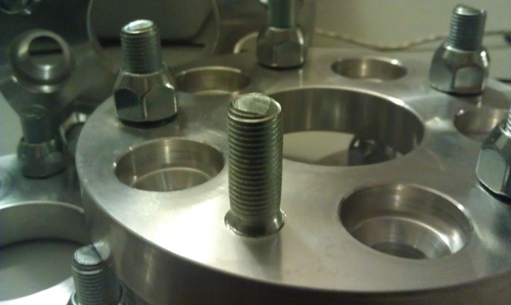

Depends on the spacer/adapter. The wheels you want to use are 53mm offset. If you use a 20mm thick spacer, you end up at 33mm total offset (53 - 20 = 33). If you use a 25mm thick spacer, you end up at 28mm total offset (53 - 25 = 28).

You may be okay at 33mm, but it will be close. If I knew the offset of the stock 15X6 wheels, I could tell you with much more confidence. I definitely would not use an adapter/spacer any thicker than 20mm.
