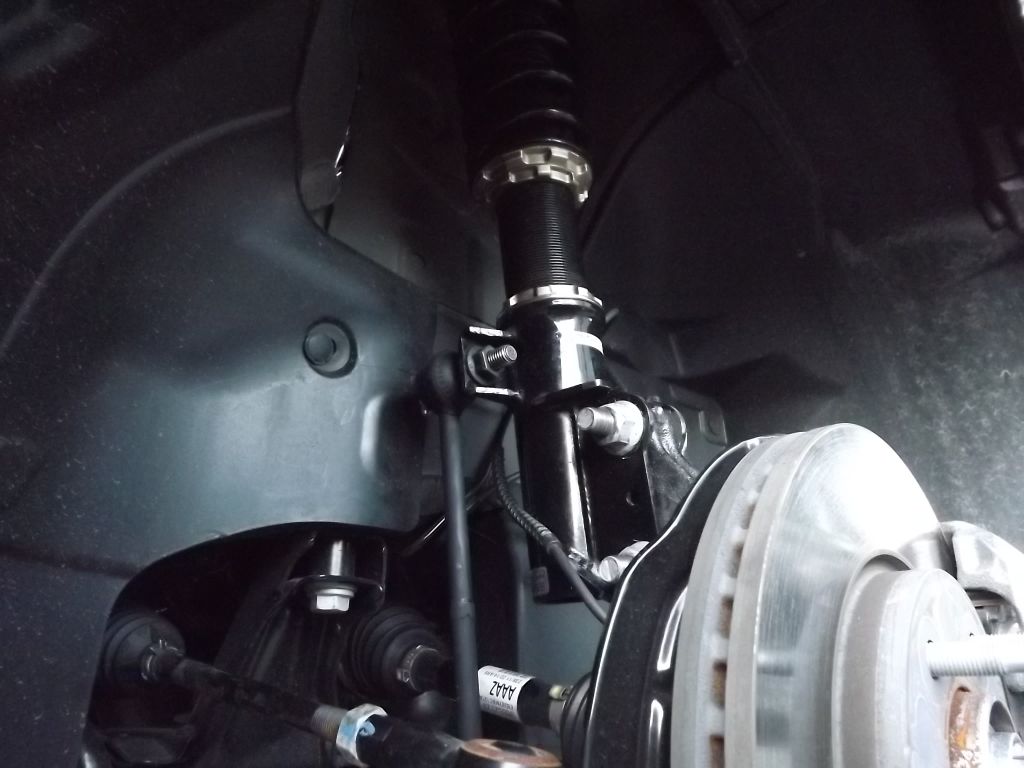

the rear is 100% bolt in completly the same
the fronts you will need to make end links message me and i will give you the mesurments you need.
and you will have to drill the holes bigger where the coil bolts to the spindle
no 100% bolt on but it will work i have BC coils for a 09 cruze in my car
