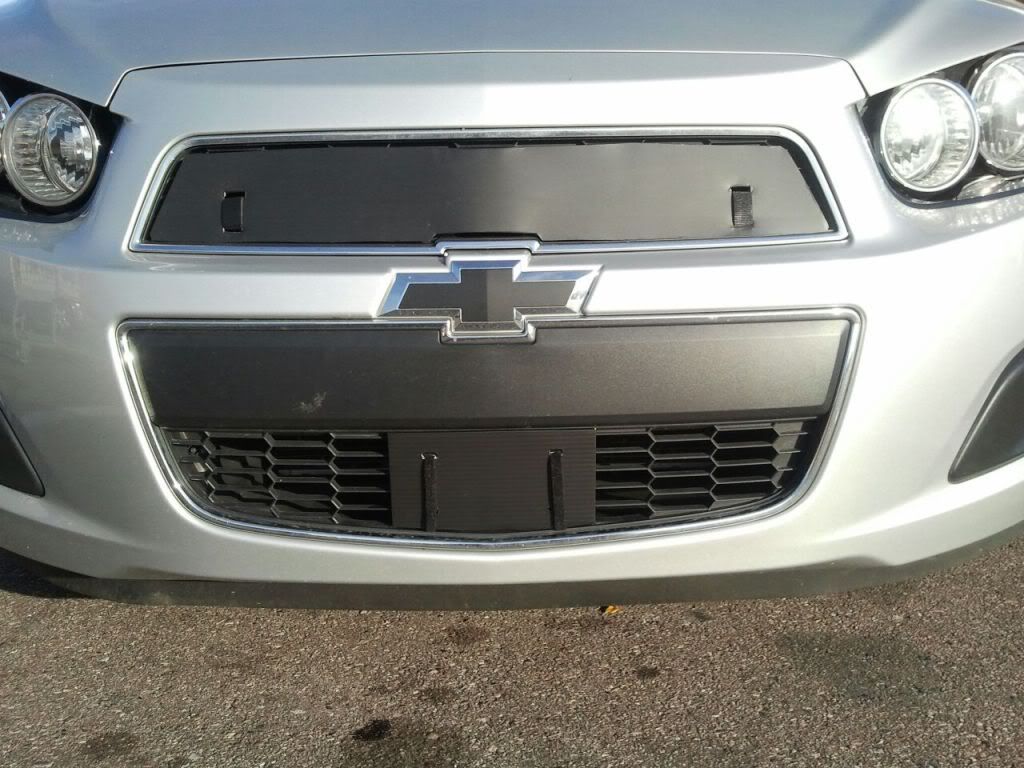

With the current temps I feel that an intercooler would still sufficiently cool things down. The grill block has reduced my warm up time with the current temps, and allows me to stay in a proper temp range on the highway.
In the winter I wouldn't worry. For summer, I have decided against the lower block because a turbo can go into a positive feedback loop in regards to heat. The exhaust is always going to be hot, and thus the turbine. Some of that heat is conducted to the compressor. Which in turn will further heat up the intake air.
With airflow going to the intercooler restricted, the heat going from turbine to compressor can start building up, and eventually further heat up the engine bay more. This is good for mpgs, but possibly not component materials. I believe the risk of something breaking because of this is small in a non-performance turbo like the Sonic, but the fuel economy gains will be too small, if there, to run the tiny risk.

thanks for the replies everyone!!(I have the 1.8l) I was definatly thinking I would devise an upper grille portion air block but for the bottom I was wondering if it would be more efficient to make an air deflector that would not be flat against the grill forcing the air up and over the car but one that I could place behind the grill angled towards the ground .
I had this thought because I figured that if the air wasn't flowing through the grill straight into the radiator like a brick wall and being deflected at a less abrubt angle to force the air under the car, it would be more efficient(in theory)
Any air that gets into the grill will go through the radiator. You would have to remove an underpanel, or cut a hole in it for your idea to deflect air down to have an effect. In which case, blocking the lower grill and putting an opening in that underpanel so the radiator is sucking air from underneath the bumper will likely have an larger effect.
Getting behind the grill also means taking off the front bumper and grill unit.
