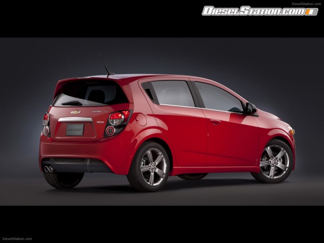

I wonder if some1 sucessfully trade the LTZ rear bumper to RS rear bumper? GM said to me they were 2 differents parts numbers so it might not be possible to switch them.
wasn't hard to do the swap at all, the only thing that gave me trouble was the exhaust of the rs is about 3 inches farther to the left of the car so you have to do some exhaust work. and the rs bumper exhaust cutout is huge, even makes my ddm works 4 inch tip look small.
i think u could find something to work, the stock exhaust i think is far enough forward to fit the rs bumper over it. then just weld a new tip on and it should look good
I confirm that we can install thro GM to the RS bumper whitout any warranty issu. I wonder where did you get paint yours Pacman?
