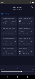

This issue is baffling me. I'm getting a p0134 message. I've replaced both of my oxygen sensors. I've replaced both of my PCV valves. I've replaced my mass air flow sensor. I replaced my coil pack and my spark plugs. My O2 sensor is pegged out at 1.25 volts but my other O2 sensor has reading . I've uploaded my data if anyone can help me on this I would appreciate it highly . Thank you
