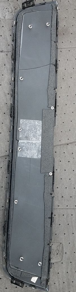

I cut the plastic used to make the block-off panels from a black painted rear bumper cover core from an SUV.
I cut them down to size, and the ends that meet to fit flush with each other.

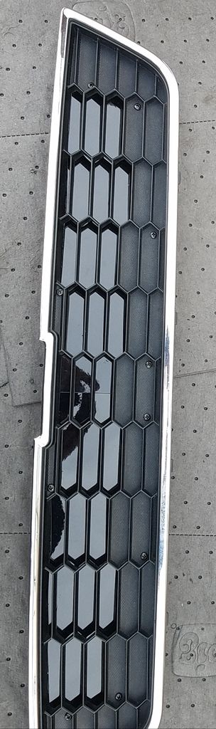

I then taped the halves together, then taped them to the inside of the grille, so I could drill both the grille and panels at the same time, to take #6 black oxide coated machine screws, 1.5 inch lenght, IIRC.
I then applied a strip of thin adhesive backed foam sealing padding to the top and sides of the grille, then attached the panels to the grille with the screws.
The grille can be snapped in and out with moderate effort.
I may add a couple of retaining screws in each upper corners at about ~75 degree angle to make sure the grille never comes out accidentally, although it seems pretty secure now.

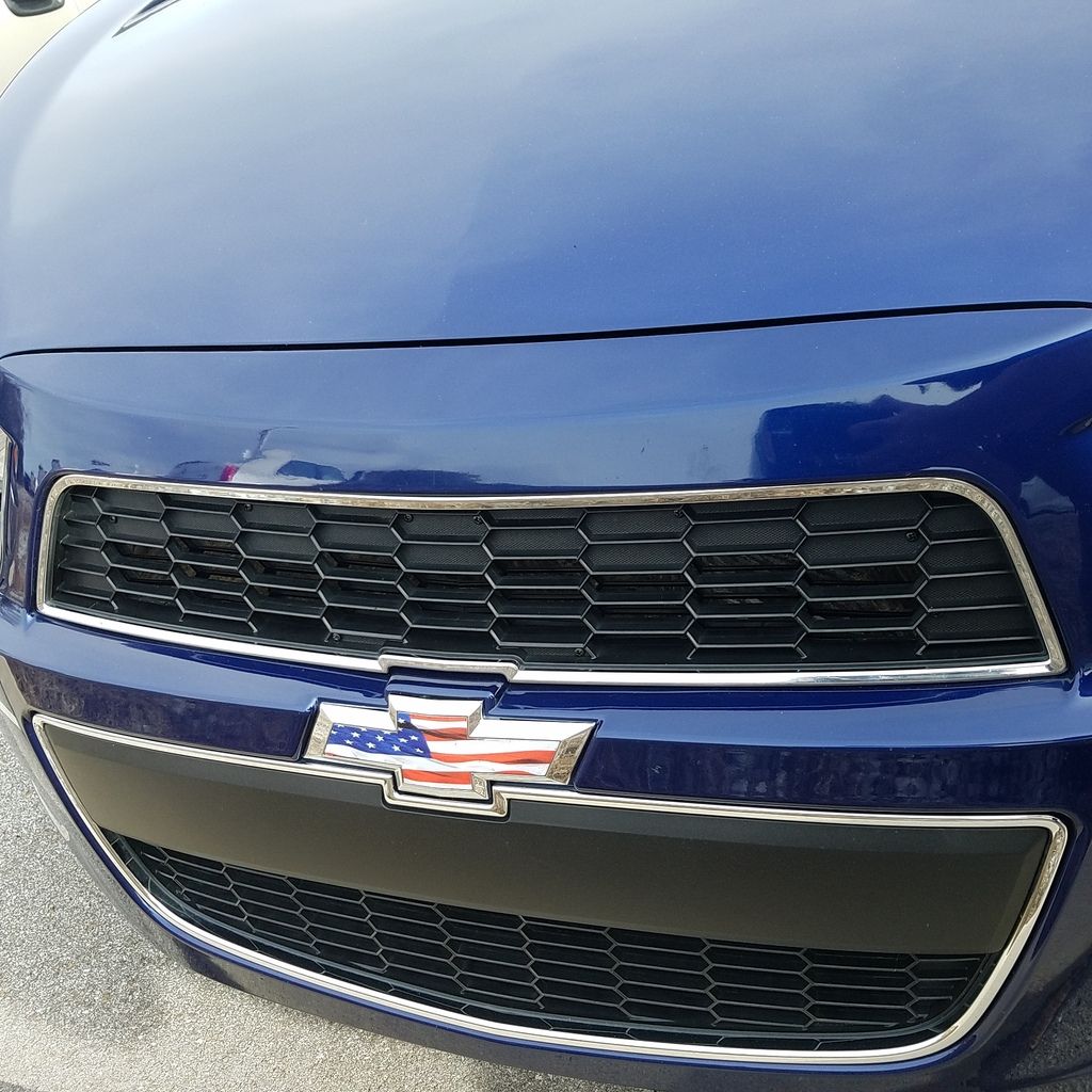

The final result is very hard to notice.
If you zoom in on the bottom picture of the grille on the car, you can just see the screw heads..
