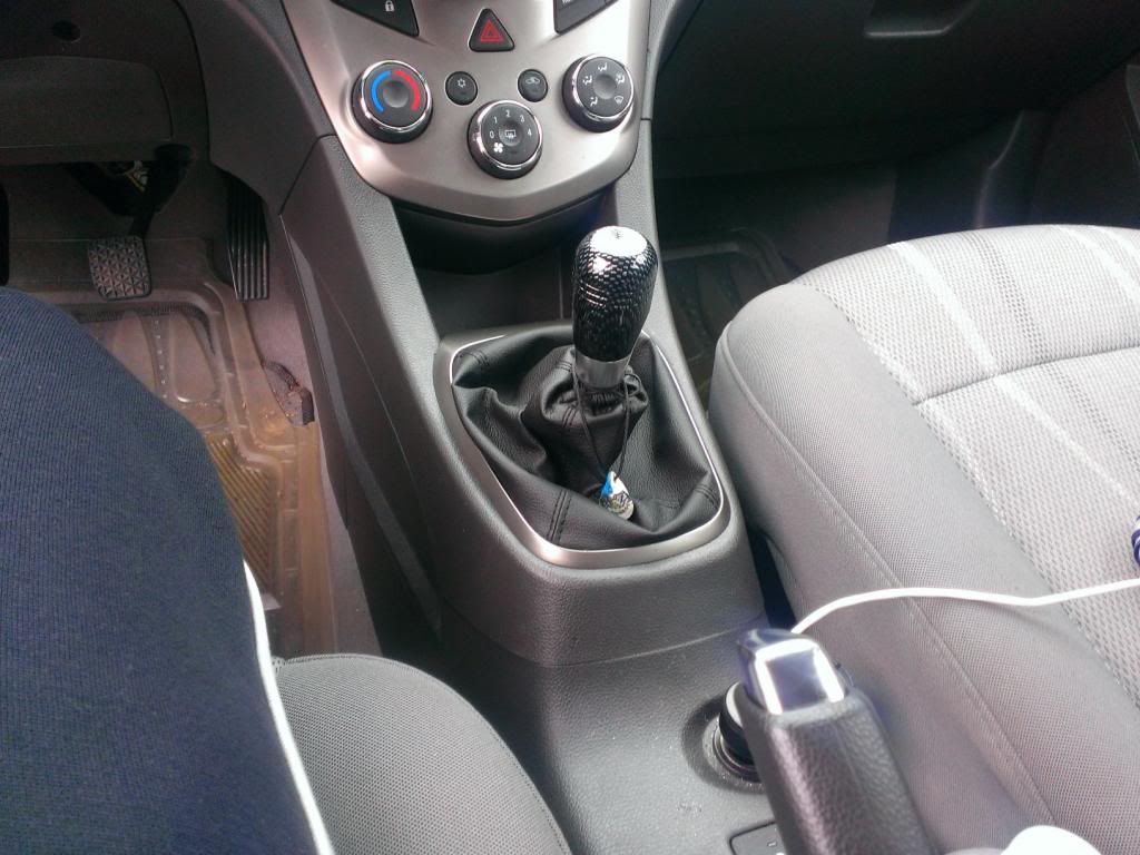

I removed the lockout mechanism in the shifter assembly, and the lockout is always down.
I see. Is that enough clearance to cut it and make it shorter?
I've had no negative issues.
So i had an idea. Im gonna run a very small led and mount it on the dash. When i go into reverse it will light up. That way if theres any accidental revrse hits i know it before moving. Nothing too bright just enough to see.
lol you'll know if your in reverse haha
A quick explination is just run a small wire back to the taillights. Tap into the reverse wire. Then on the other end, attatch it to the positive of an led. Then ground the other side. Then just mount it. Done lol.
yah i removed it completely. havent had a problem with it and it looks fantastic just waiting on ddms short throw
