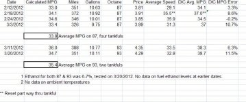

- 87 and 93 do not have equal energy content, 93 actually has slightly LESS energy per gallon! But with more ignition advance, you can get more torque and efficiency.
I have been short shifting at 2000 rpm and below, keeping boost between -1 and 1 psi. So at low rpm and relatively high (for commuting) 40-50% throttle load, ignition could make a measurable difference.
- If you shift at 3000K+ rpm, at a lighter throttle input, then you may not notice any difference

- I understand the placebo effect, I also mentioned it in the thread above. To measure small changes, like <10%, you have be very careful about keeping all the conditions consistent.
I just ran 4 tankfuls of 87 (10% eth), now I'm gonna run some tanks of 93 (10% eth). I'm not claiming the results will be 100% accurate, the driving mix may be different, traffic, etc but averaging over more tanks will smooth some of that out. A big factor will be the warming weather, less warm-up time, less highway aero drag, all these are just ~1% effects, but they can skew the results.
Again, as I said earlier, the only way you could get a difference with identical driving styles is the amount of ethanol in each. Where I am, 87 is 10% and 91 is 0%.
Eric, I agree, ethanol screws up your fuel mileage. But again I don't agree that's the only way, like I said above.
