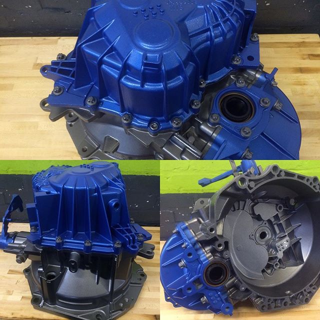

M32 Gearbox | Guide To Faults & Fixes
A guide to the common faults and repairs including up-rating the Vauxhall, Alfa Romeo, Fiat M32 gearbox . If you are unfamiliar with its factory name the M32 gearbox is the common 6 speed gearbox found in most Vauxhalls as well as Alfa Romeo and Fiat. M32 Gearbox Symptoms So chances are if...
