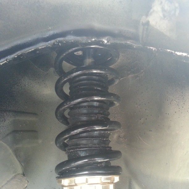

i had to roll my fender cut the plastic inner fender and bend up the body weld like a 1/2 so i didnt cut my tire and i still rub
iraqivet
Banned
Iraqi whats a body weld? do u have a pic?
yes the body is pinch welded and it runs in the wheel well.
( and i thought you said you were low? because your not low if you dont know what that is because it ters up your tires )
this is one side after bending it up and spraying some paint on it

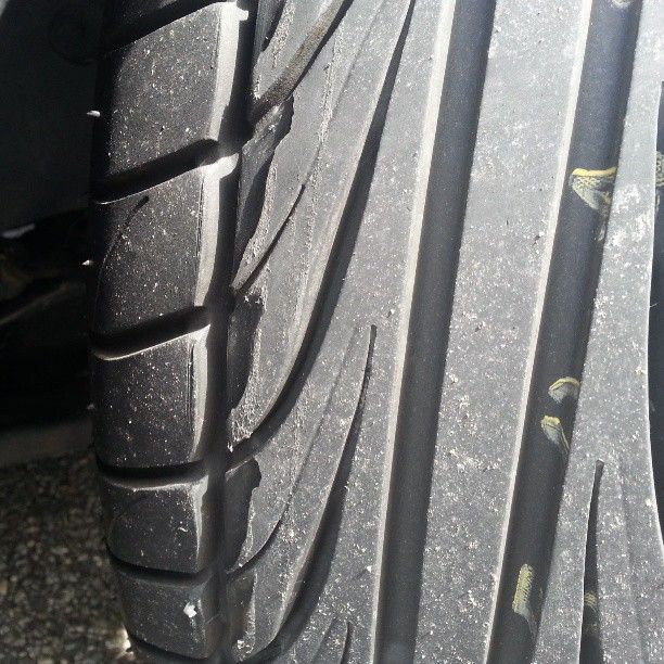

also this is what hapens to the tire

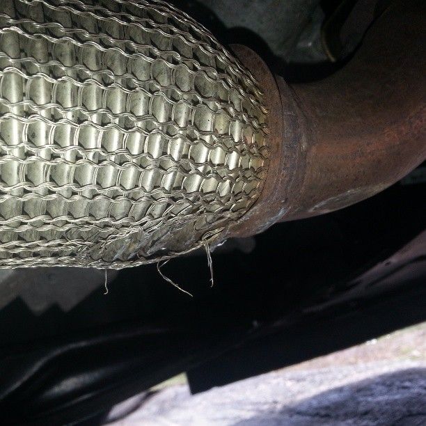

and just some other random damage from being low

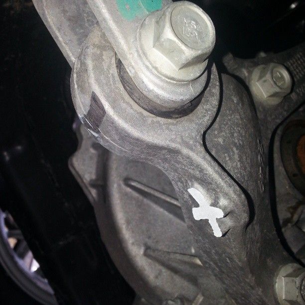

and this is the trani snapped off the X tab and dragging it were the trani mount mounts
