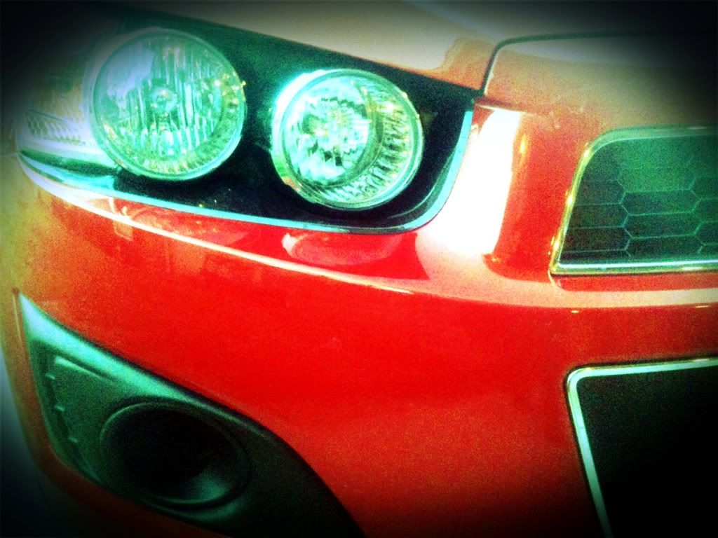

I used a dremel on low speed with a roto-zip style bit to grind out the ports on the fake grilles on the fog lamp blanks.

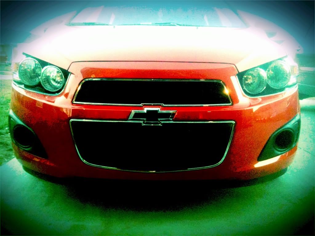

Finally I re-assembled the bumper and connected the tube by putting the fog light back in last, I accessed the tube through the wheel well to position it correctly. (I will probably paint the screws black ot match the rest of the trim)
