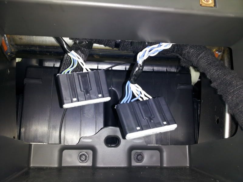

Remove the rubber boot that covers the wires going to the door, and remove the shackles of wires. The photo identified two extreme wires, just a sound.
How to connect to the wire - it is yours.
